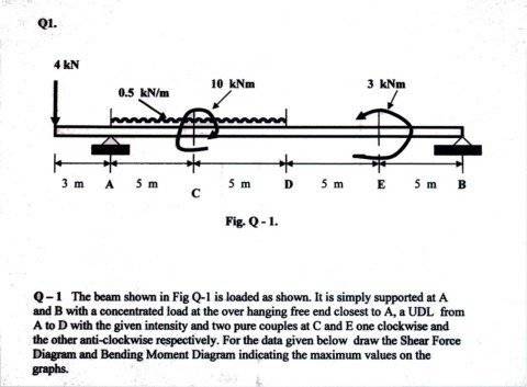

hey guys this is probably very straight forward stuff for u but i have an example question on a loaded beam. there is a UDL, 2 pure couples and 2 fixed points.
now how do i do the shear force and bendin moment diagram for this

A sketch of the idea would do some good.
In general, the relation dM(x)/dx = T(x) can be very useful when constructing shear force diagram. (T represents the shear force, and M the bending moment.)
Set up the equations of equilibrium for the beam at some point x to get the bending moment function M(x), after calculating the reactions.
heres the pic of everything
how do i include the couples in the diagrams i haven't encountered these b4

First, what is the method you were taught to draw the diagram?
Graphing the piecewise function and/or the area method?
i think ud describe it as the graphing piecewise function although i haven't heard it described as tht b4 ne I am from the uk so not my fault :smile:
basically this is what i use
http://www2.umist.ac.uk/construction/intranet/teaching/ul222/exp/sfbmdex.htm"
is there a "better" way I am sort of teachin myself this stuff really ne help would b hugely appreciated :smile: iv got another problem I am stuck on but i wona give it a proper go b4 askin learn better tht way if u can solve something yourself

So, if you're looking at piecewise section from the left end, you would, as usual have M(x) = sum of reaction to moments from -4kN, R(Ay) and the distributed load, for 0<=x<8, and beyond that point, you also include the reactions to the pure couples, so that M(x) = all these contributions + couple at C, for 8<=x<18, and M(x) = all of previous contributions + couple at E, for x>=18

so basically i jus add the couples to the other loads at C and E, how would this look visually?

wow those 2 images are great, the shear force was exactly how i pictured it and the bending moment explained the couples

Moments about a Clockwise:
(10 x 5) + [(0.5 x 10) x 5] = (4x3) + (3x15) x (R/b x20)
75 = 57+(R/b x 20)
R/b= 18 / 20
R/b = -0.9
This doesn't seem right, what have I done wrong??
to find reaction R/a using all Upward=Downward
R/a + 4 + 3 = 5 + 10 + 0.9
R/a = 8.9
help

I'm too lazy to check your calculation, but I can demonstrate how it should look like. Let's set the sum of moments around point B to equal zero, to get the reaction Ra at point A (which is assumed to point 'upwards'). Assume clockwise moments are positive. We have:
-3 + 10 - 0.5*10*15 + Ra*20 - 4*23 = 0.
so ur asuming that Rb will equal 0? or is there another way of findin Rb

I'm not assuming Rb will equal 0. We only set the sum of moments about the point B to equal 0, right? So, the reaction Rb does not produce a moment at this point. Thus, we have one equation with one unknown, Ra, which we can solve easily.
Further on, you can easily google-up some basic information on the construction of internal force diagrams. If there's something specific you wish to know about, I'll be glad to help.
